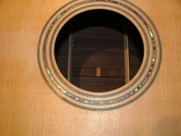

I like to use either the same wood as the back, or the same as the bindings for it.
As a "signature" thing, I'll include a piece cut from the back with the backstrip in it, and put that piece right below the soundhole. Yes, corny I know, but it's fun for me.

[QUOTE=Don Williams] As a "signature" thing, I'll include a piece cut from the back with the backstrip in it, and put that piece right below the soundhole. Yes, corny I know, but it's fun for me.
I've got one of Don's guitars, and that little "signature" thing always generates a universal positive comment. A guitar buff spots a little detail like that immediately, whereas a non-GAS afflicted person never notices it.

Hey Don, do you have a pic? I'm not exactly sure what you mean, and I couldn't find an example on your website. Do you mean you put a small piece in the backseam?

Hey Don, I have done the same thing. It looked really good with the mahogany back wood and the center stip that was paduk and holly. Makes a nice touch. I really did not copy you, just similar thinking I guess.

Here's the only photo I could find of Don's additional centerseam thingy...best photo I could find. He probably has a better one.
Bill
